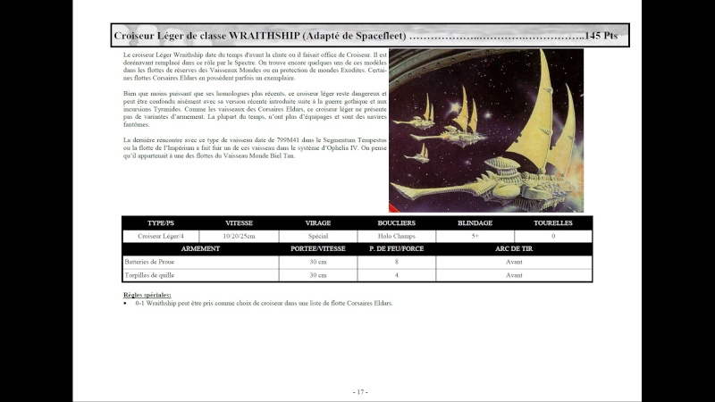

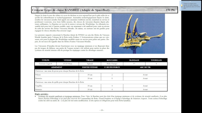

Should you want something a bit different, here are the french BFG forum Spacefleet Wraithships, (extracts BFG FR Add-On Eldar Vaisseaux Mondes - "Craftworld Eldars")
Wraithship Eldar Early Age (not golden age) version
Banshee: Spacefleet Wraithship Refited with 40K modular Craftworld Eldar technology
