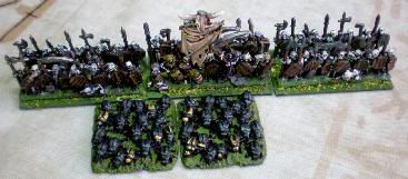

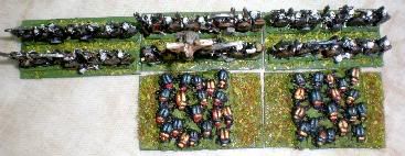

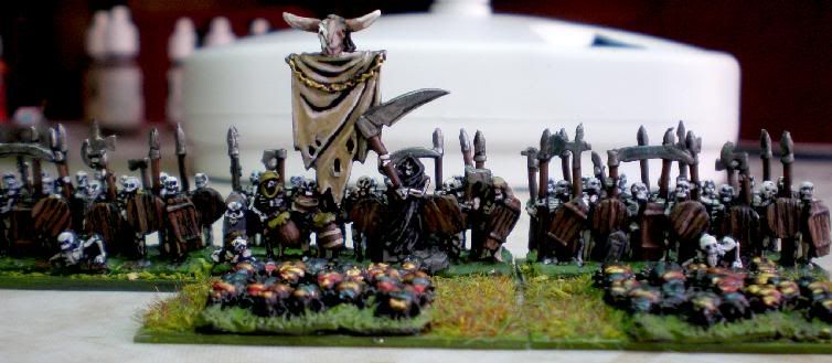

As I see interest for the models I should tell you that the metal base is an square and little big to fit in a warmaster base.
The first idea (and I still reconsidering it), was to not base them, so being a unit of 2 stands when charge (as in the pic) will attack only two enemy stands (center to center of the nearer enemy stand). Also do not have rear or sides and the base is an square (makes sense for me), this make the unit a little "harder attack". But then I think that different base for infantry will be a major change, and I am not to fan of major changes, so I base them as regular frontal for warmaster and add the depth becasue the figure needs it. Then when charging combat with 3 enemy stands (the third corner to corner) and will make it less effective.
In terms of simulation being less effective does not bother me, because scarabs swarn then will have chance of beating a reduce/injured unit of two stands. So the insects goes to the wounded, and does make an realistic strategy of using this swarn unit rather than charge frontally to those fresh enemy unit.
PS: The dudes of the "Tale" ignore the up pic, I was reserving that unit for the very busy weeks that came to me in my work ;)
