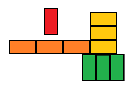

Although this isn't the exact situation the OP describes I think it's a simple visual away to address a similar situation:
The green Chaos Knights have hit both  the Orc Slaves (yellow) and Chaos Dwarfs (orange), forcing them back. The Wolf riders (red) will not give way to the falling back Chaos Dwarfs, trapping and wiping out the centre stand.
How should the remaining Chaos Dwarf stands be placed?
What if the Wolf Riders are angled to prevent the Chaos Dwarfs forming a column behind the one in combat, assuming that move is possible (I'm not sure if it is)?

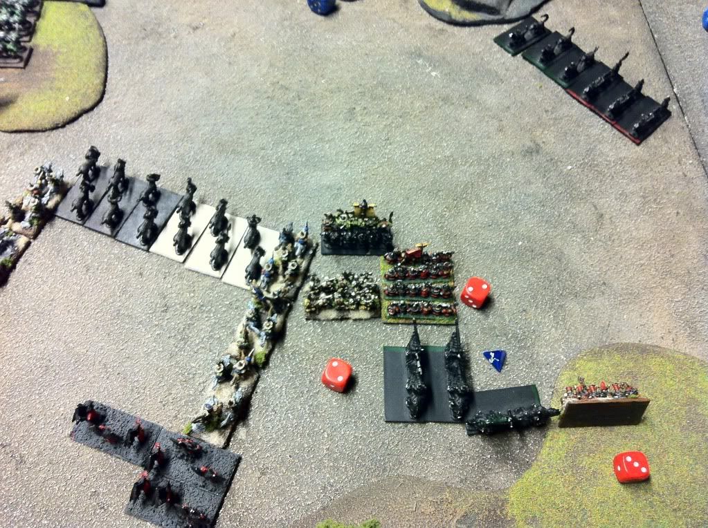

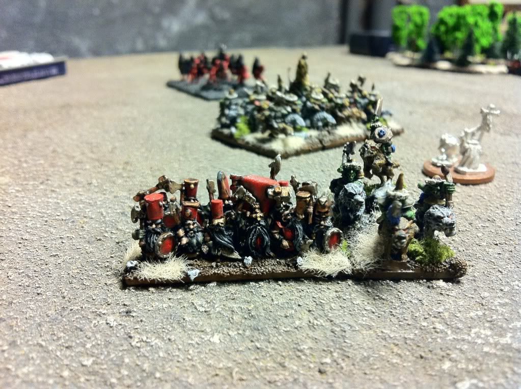

Hi guys!
I was the other player and I have a picture of the actual occasion, here it comes  :)
This is right after the middle stand had died. The OS and CDW were forced to retreat 1 cm each from the nights. The middle stand of the OS connected with the GWR and they couldn't make way due to being in combat to their rear with some harpies. And apprently now that I see the picture the OS must have been in irregular formation (the leading stand seems to have slided a bit, this seems really strange to me cause I can't remember what would have put them in that strange formation. The hole situation might actually have been due to a misstake, can you remember why they were like that wmchaos?
In the end the only survivors on the chaos dwarf side (2 units of CDW and 2 of OS) were these guys
(this was after killing the knight unit in my turn though with the help of 1 unit of GWR ;D ). Those knights were insane and managed an obscene amount of saves before going down.
Thanks for a very enjoyable game wmchaos, I learned a great deal about the game!
