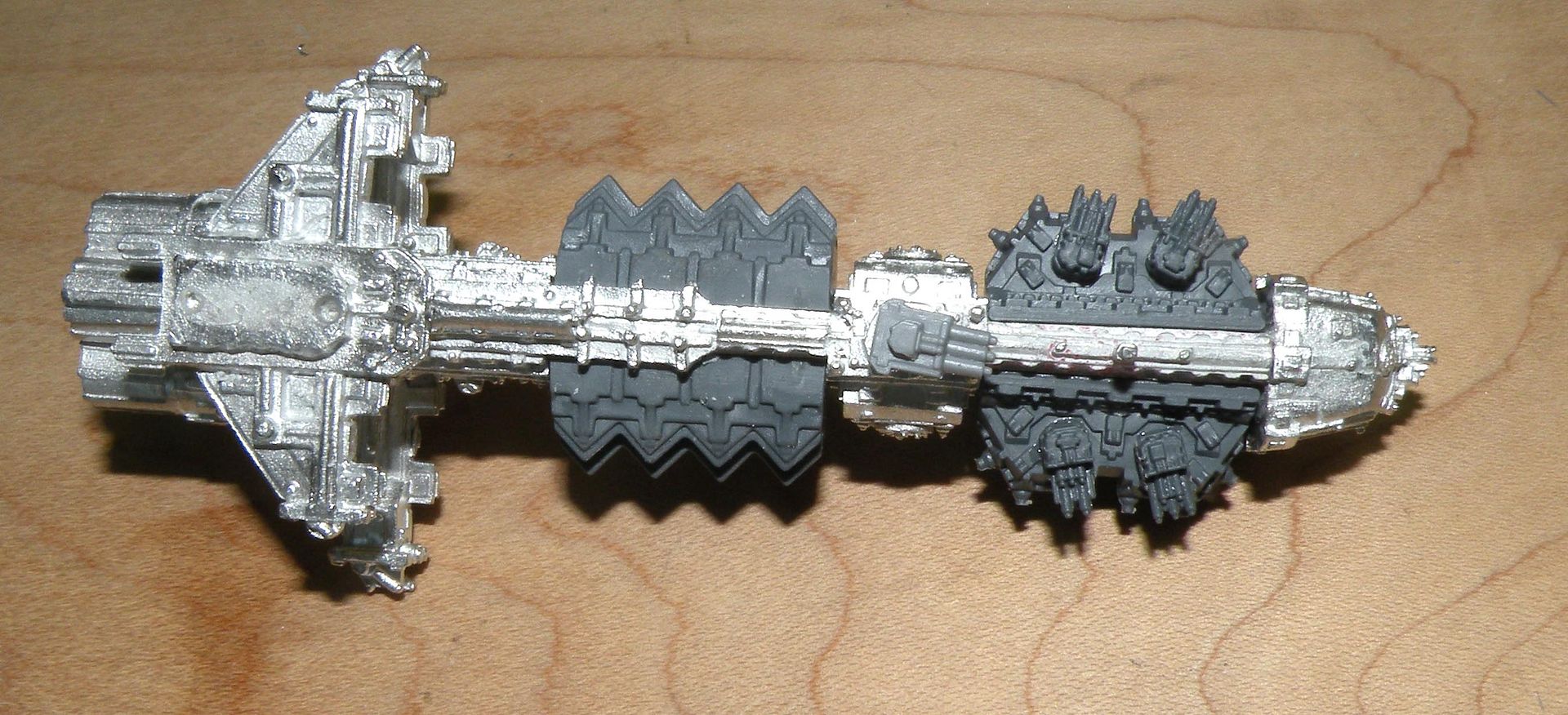

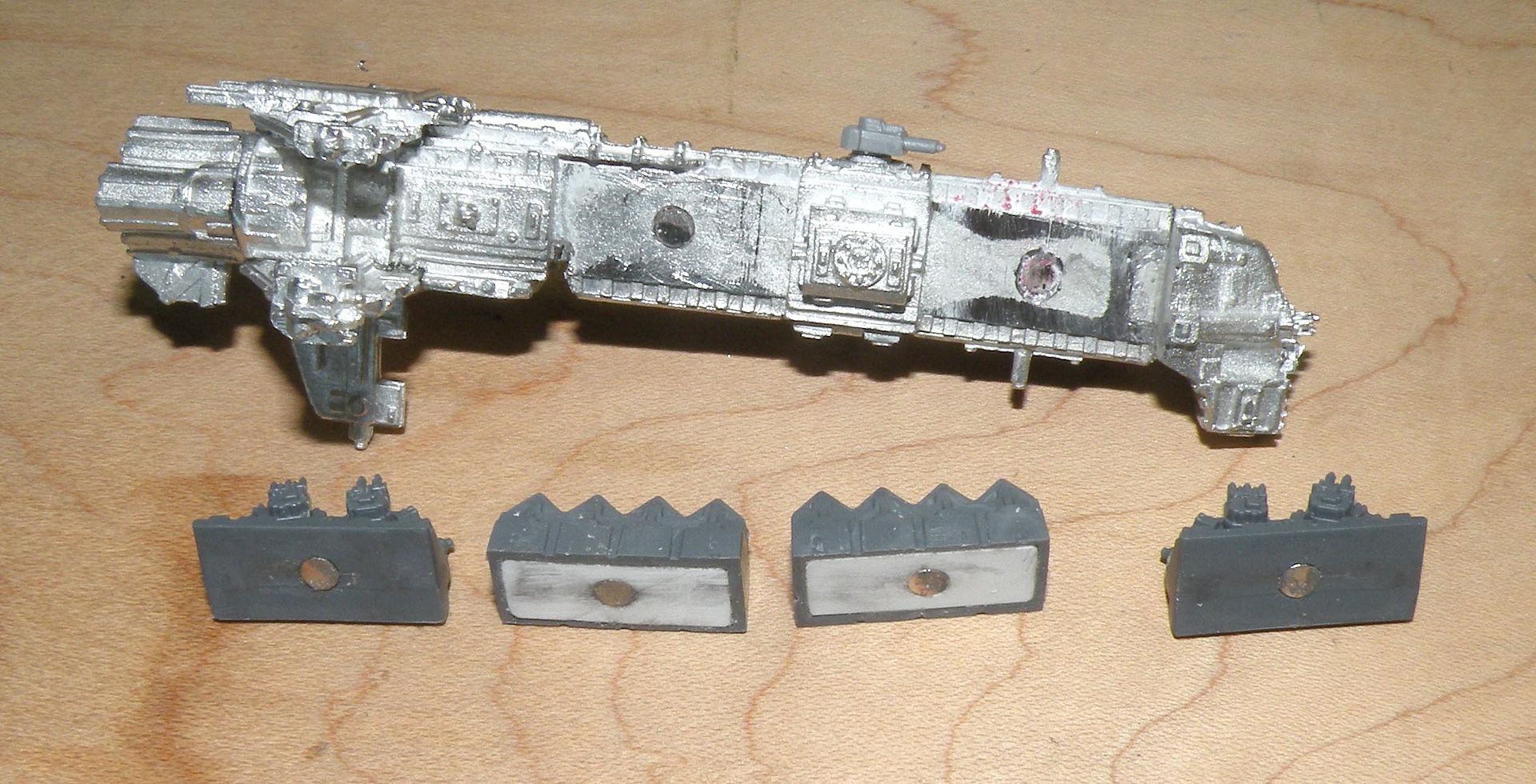

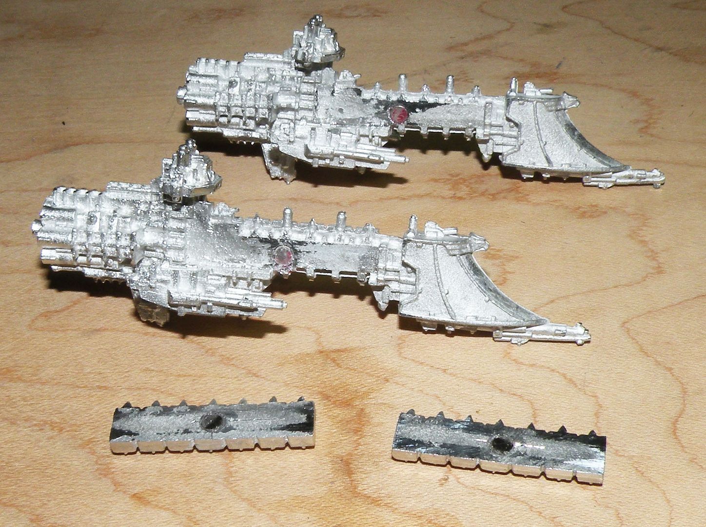

Dauntlesses with magged WB with proto LB and lance bays in lower pic. Hulls have two stacked 1/8" x 1/16" magnets (hole drilled all the way through the hull) and WBs have one 1/8" x 1/16" magnet each. For WBs 1/8" hole was drilled partway through and then the hole bottom flattened with a 1/8" carbide end mill so the magnet would sit flush with the back of the WB. Would suggest using 1/8" x 1/32" magnets for the WBs.
AdMech Cruiser with magged LBs and lance bays.

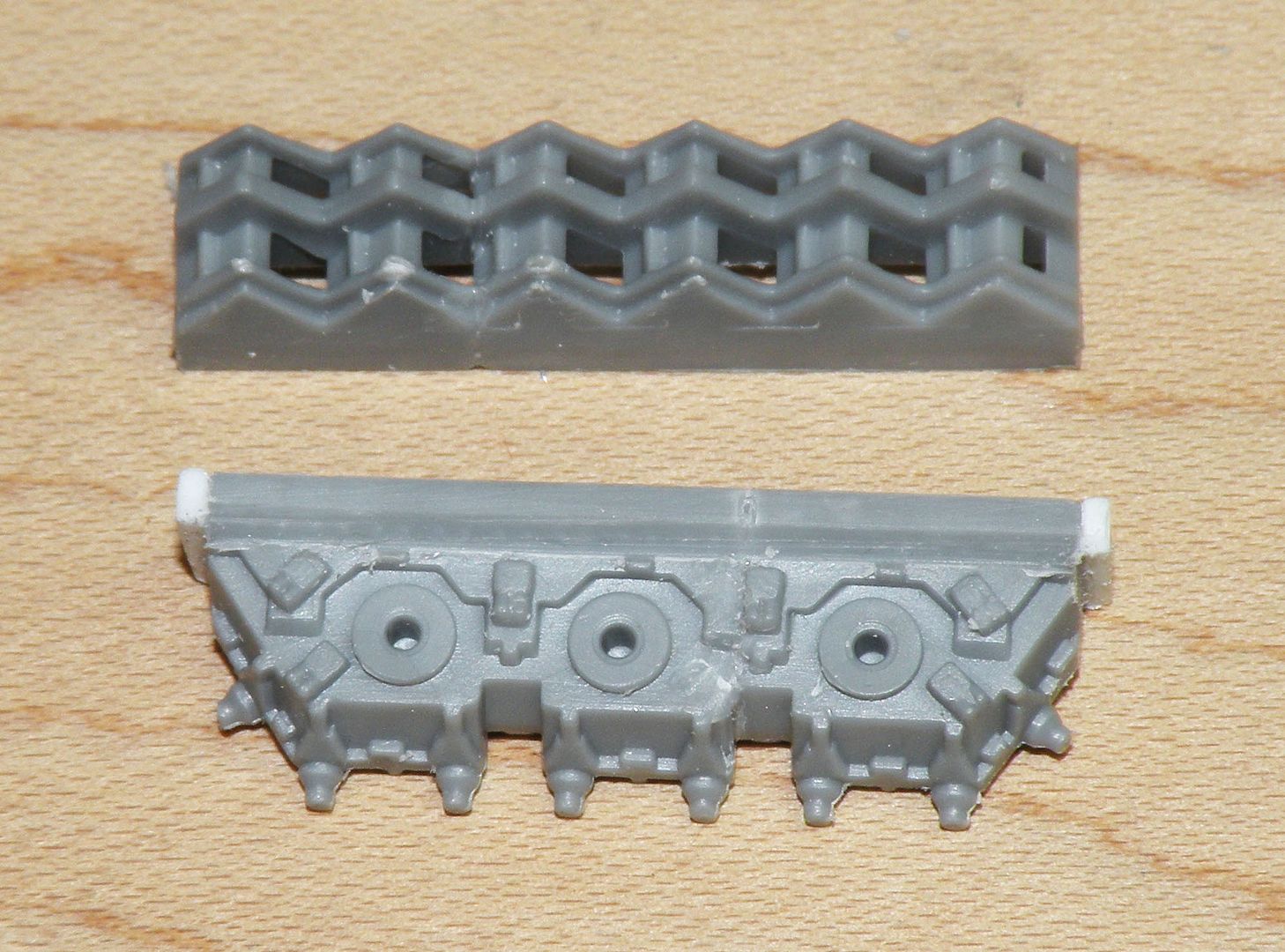

.080" x .250" plastic bar fits the LB perfectly, giving a backing to drill the magnets into

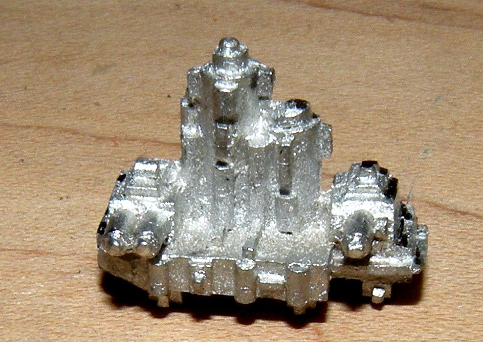

Mystery piece... to me anyway. Anyone know what this bridge goes to? Its a bit larger than a Dauntless bridge and has gun turrets.

I do believe that's an admech cruiser and not a bridge piece ;)

That piece in the final picture is one of the side gun plates from an Ork Kill Kroozer/Terror Ship.  One mounts on each side, roughly amidships between the head and the engines, above the wings.  If/when I ever build a Space Ork fleet again, it's all going to be scratch built, because it is terribly hard to believe that those metal models represent 10 hull points or a reasonable amount of firepower (let alone mekboy-approved quantities of gun barrels sticking out in all directions).

Looked a lot like a Dauntless bridge and even has the two ribs on the bottom that fit the Dauntless. I think it will become part of the bridge for the AdMech cruiser above...

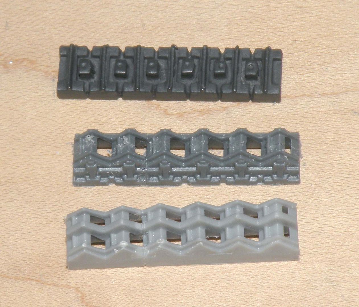

Small update:
Didn't like the first LB setup so made another one (middle one in pic). Razor sawed the center rib out and glued the two pieces back together.
