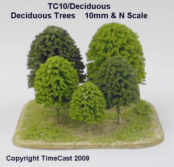

I don't really know, i bought them with a lot of figs few years ago. Never used them before.
But if you want my opinion they are nice but not the best types. I prefer those from TimeCast for example :
They are nearly similar but not exactly the same. TimeCast one's branches are a little bitt less straight.
Type "Tree 10mm" on ebay and you will see some few interesting things. And if you scroll down the ebay page, you will see things that approx matches the research, and you have plenty of trees from various sellers and types.
