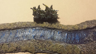

« Reply #5 on: February 01, 2015, 02:36:58 AM »
the linoleum sounds like a great idea actually!
I cut my piece last night, spray painted and "jazzed" up some lines for water splashing against my rocks BUT in the amount of time it took for me to put the black spray can down and dab my little paint brush into the paint and put the line on, the black primer had dried!  So the lines didn't come out like I wanted at all.  It is too black for my liking, maybe put some blue around the middle?
It also warped just a hair.  I like the idea of the linoleum so I will purchase a few of those tiles at the store tomorrow to try it out on!
I think I will spray paint the whole thing a really dark blue and leave the center blue with the black primer and then hit the final product with the glossy enamel again as that does look really good........
I had a thought half way through typing....bent the river back into place with no stones popping off. and painted the edges with some dry brushing and really dark blue, you guys tell me.  should I keep going?  and be honest!!!!

« Reply #8 on: February 06, 2015, 03:09:13 AM »
my river terrains.
I liked the first one enough to decide that since it's free to me minus my time doing it, I might as well see how a whole river like this looks.
Spray paint black.  Put in the almost white lines, using some chalk art skills I rubbed the lines with my fingers to soften them.  Flock with stones if needed for a fording area.  Then used a "RIPPLED EFFECT" clear coat which makes a textured surface on them like really really REALLY old glass as it tries to revert back to it's natural liquid form.  I will admit, this paint didn't do the effect like I wanted until coat number three.
After the spray painting was done I had a surface I could dry brush with the really dark blue around the edges of the river sections.  Then one more coat of the "RIPPLED EFFECT" and finally, had to bend the card stock back to flat as possible and then I added some "weeds" flock over the rocks to really sell the fording area.
Last but not least a really light coat over the flock just to seal it in with a clear matte coat that you cant see at all but wont let the weeds fall off.
They look a lot better than I thought so I guess I will keep them.
The reason I didn't just get a river kit from an online sight was because I didn't want the raised up edges of the rivers to hold in the realistic water.  Though those things look amazing and I absolutely love them I just can't get past the raised up edges.....It's me not them.  ha
