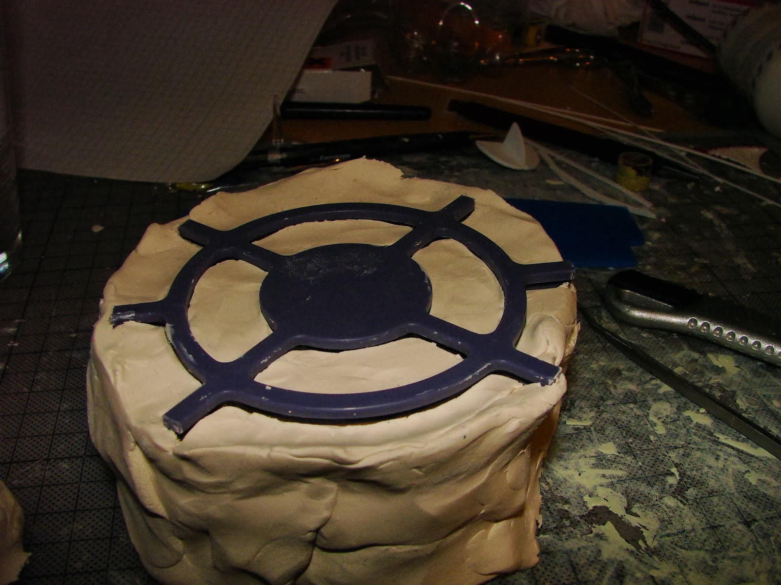

Step 1 preparation.
Prepare the plastiline. you will need a plane surface and you should be aware that the resin can felt to your table so secure everything.

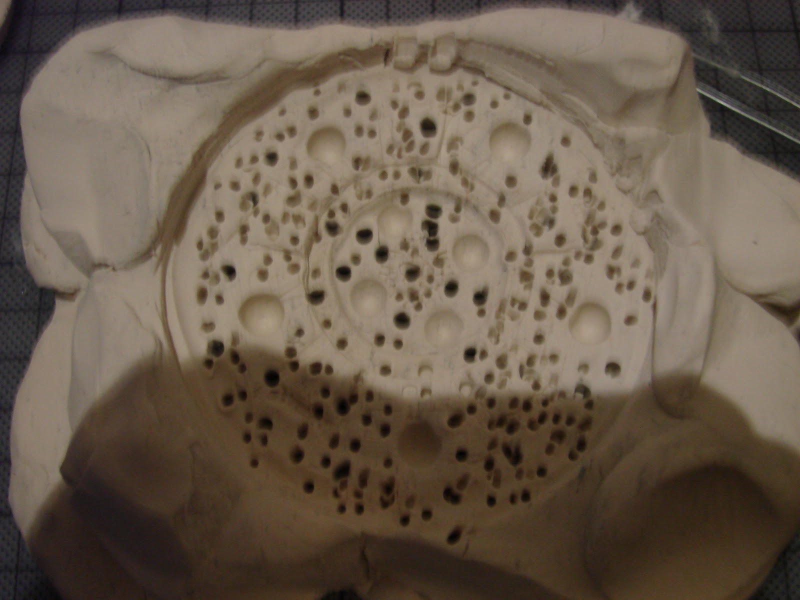

Step 2: Negative.
Now we are going to build the city we want but in a negative, first make a negative of the surface you want the city, then using the different shape tubes just give the plastiline a random shape. the result should be the plastiline with a lot of holes and a shape in with you can place the miniature secure.

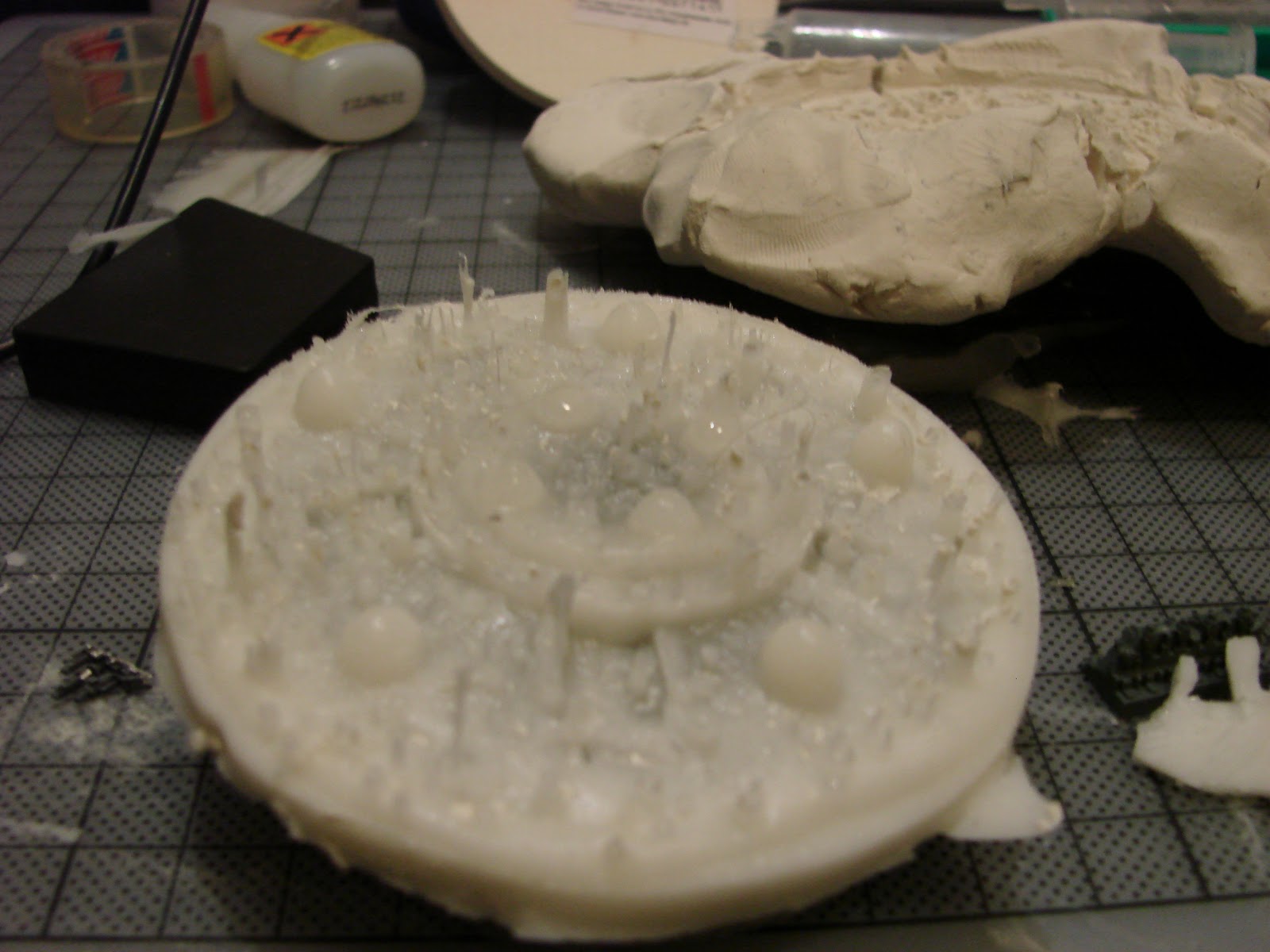

Step 3  Resin casting
Just pour the resin on the negative, If you are using this method in a surface you must put the desired surface in contact with the resin around 5 minutes after pouring, just before it harden.

Step 4 clean and final details
When the resin is ready take the miniature or surface and cleans the plastiline rest. Now take a look on your space city, now just cut the borders of it and add the final details. You can add plasticard pieces to make more solid buildings and get rig of the bubbles.
You can do really funny things with it
